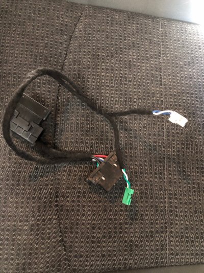

I’ve got a brand new unused 2018 security bypass harness for a 2500 made by Deereguy. If anyone wants it send me a message! I have a 1500 and was shipped the wrong one. But he was nice enough to tell me to sell it rather than return it. d682ff3f849ed1a4d6c115b5a6acc6a3.jpg
I’ll buy it from you
