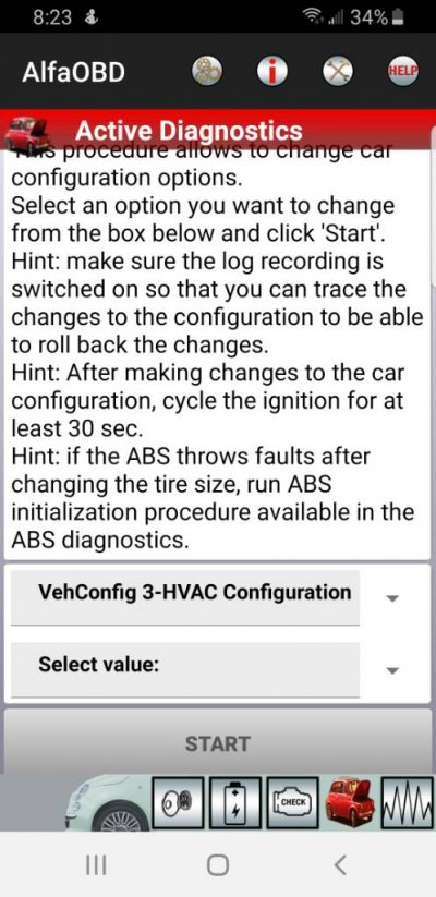

That's exactly what I thought it sounds like your truck is set to the single zone manual temperature setting in your HVAC configuration in your BCM. I know you have put everything back to stock but by chance did you check to see what your HVAC settings are set to with the alfa tool? It should be set to (Dual Zone ATC.) 6685344997ea0771a9c00421f20fdfb1.jpg343cb0adaf8e6d0f4c50c92ecbd1953c.jpg

I have not checked that out. Will have to do that on Monday when I return. Thank you for pointing that out!

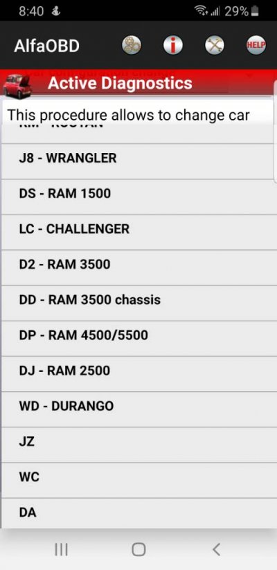

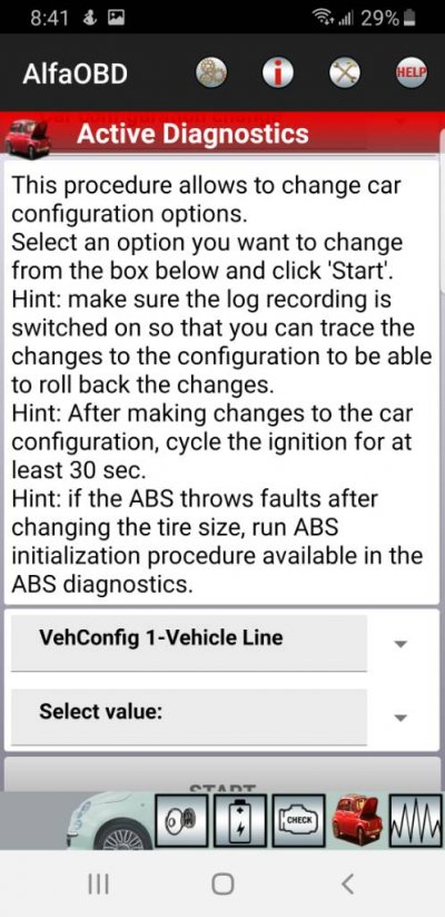

Might be it you never know. The question would be why would it change? You may also want to check your vehicle brand and make sure it's set to Ram 2500 DJ I believe is what it's supposed to be. This is what your radio uses to detect what screen themes should be on your radio. Once again just a thought. I have no idea why these settings would be changed. ada00067be5b9f55a45faf1117457d96.jpg9bcebea2a4a0dc4b90a8c42de3468b51.jpg
