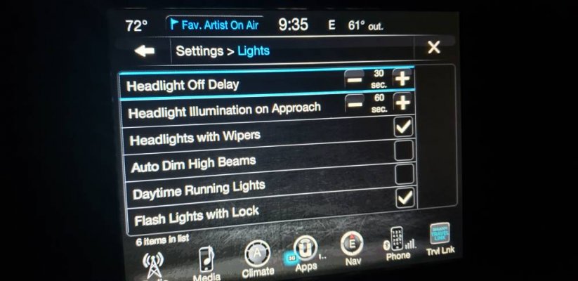

Yes it should appear under the lights section in your settings menu. b64c5afb9a78c7641531aa3dbb83936c.jpg
Just to keep straight the DRL in question is a Canada truck, as mine is. I did get the option to show in my screen adding it to the CSM menu, but check/no check does not turn off the DRL. In comparing some BCM's I noticed that under CBC Config that my Canada truck has
DRL Configuration: Canada DRL
DRL Lamp Location: Dedicated
DRL Dropout Enable: Set
And a 2015 in the BCM google drive I'm comparing to has
DRL Configuration: Optional DRL
DRL Lamp Location: Turn Signal DRL
DRL Dropout Enable: Not set
So I'm thinking there is the Canada option that keeps from allowing complete control, will try when I get home.
i got it figured out.
it appeared that the enable DRL setting under Program Customer Features did not take.
I went back under Program Customer Features, Daytime Running Lamps, selected enable and then start.
after that, I have the DRL setting under lighting on my screen
