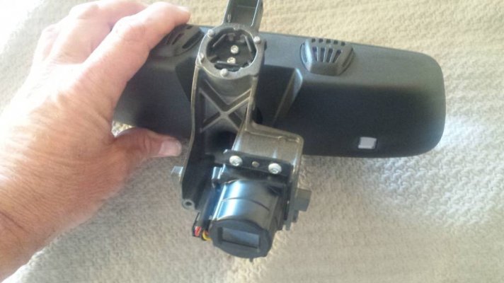

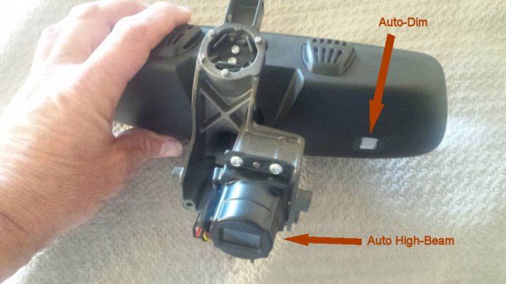

Did you install an auto high beam mirror that has the extra light sensor like this one?dc988fed576e5697457681db59bc6cf2.jpg
That looks like the one I have installed. It was a junkyard pull by someone else so it may not even work, but this is likely an operator issue.
