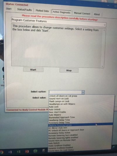

You can try to change one setting at a time and let it sleep between each change, that's what I do and I have never had an issue.

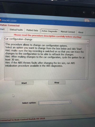

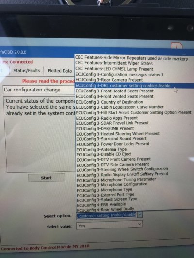

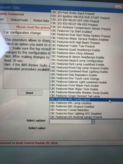

Well. I just went through all these settings:
And they all say:
Sorry to make this a long post but I hope it helps others too.

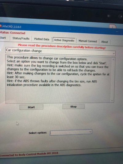

So to make sure I’m doing this right: go to active diagnostics then car config change?

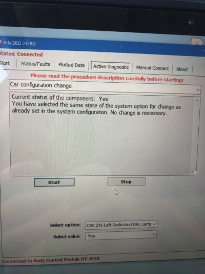

Here are the first two on that checklist:
Both are set to yes.
Here’s the next three...one selected and the two below:
Next:
Next:
Finally:
Then showing nothing shows up here yet:
Hoping it’s something really dumb that I’m messing up!

@Tankerpilot01 You do have the CSM set right? Sorry if this has been answered. Haven't been following too closely.
Customer Service Menus: Daytime Running Lights CSM
Select “yes
Edit: The program customer features just enables/disables them. The CSM is needed to show in the 8.4 settings.
And they all say:
Next:
Next:
Finally:

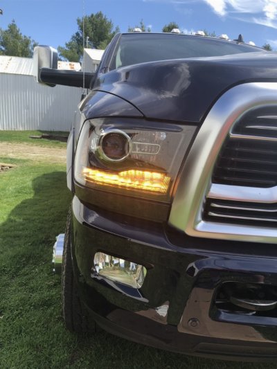

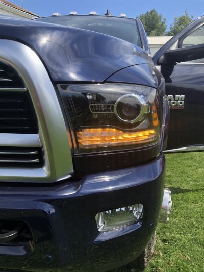

So all I had to do was take 10 min doing all that and my next trip into town I see this in the reflection lol
Now I’ll work on getting into the settings

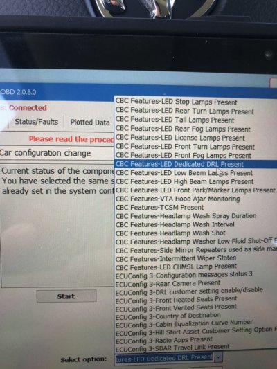

Hello any info on changing the setting for low beam lights to led
Yes you can change lows to led's. Under body Computer 2013-17, car configuration, it will be about half way through the list in the CBC list along with highs, reverse, fogs, turn, park, license plate, rear turn and brake
Select “yes
Thought that’s what this was:
Apparently there is another item/location I’m missing?
How do I get to the CSM? Is it in the same area?

Perhaps it somewhere other than Body Computer?
If you go to post 1 and look for my name I have step by step instructions with pictures. Although it's done through the android version the steps will be the same

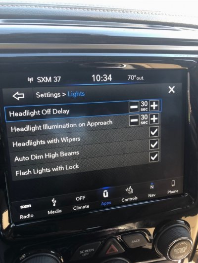

You may have everything enabled already. It could take it up to 24 hour's for it to show up in the radio
Or a radio reboot, that's what mine took.

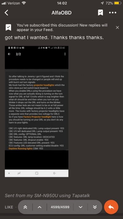

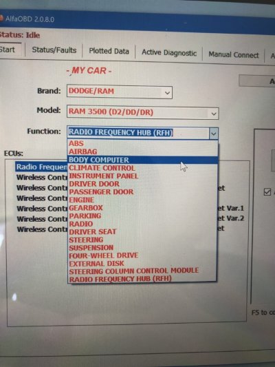

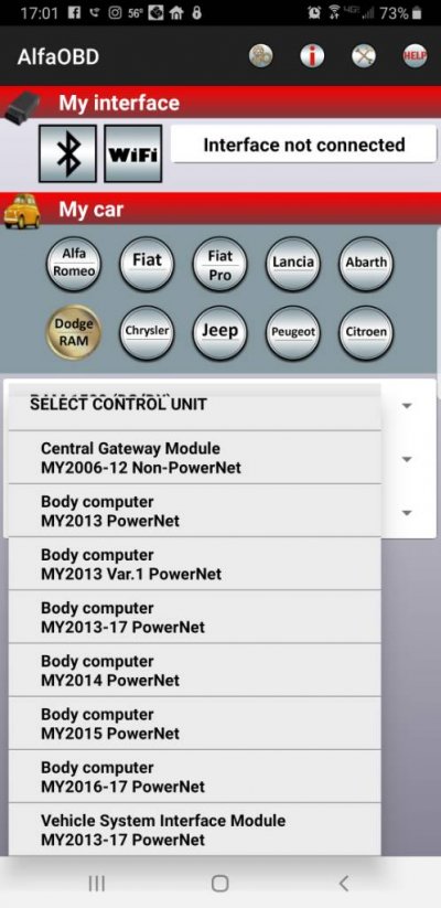

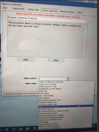

Ok. Hooked up my bypass harness to my truck, and hooked up the obdlink mx. Was into the body computer and used MY2103-2017 control unit. I was able to turn on and off the turn signals, tail light, head light in diagnostics. Not sure how to make changes. Was playing with it for a bit but couldn't figure how to get to the settings for DRL or the fog light drop out setting. Am I missing something?
I just took a screen shot of the Alfa screen while I was inside of the house just to show the difference from Ghost Rams screen shots. Thanks guys.

Ok. Hooked up my bypass harness to my truck, and hooked up the obdlink mx. Was into the body computer and used MY2103-2017 control unit. I was able to turn on and off the turn signals, tail light, head light in diagnostics. Not sure how to make changes. Was playing with it for a bit but couldn't figure how to get to the settings for DRL or the fog light drop out setting. Am I missing something?dc25dfdc6f0865a6de1ed7487a61faec.jpg
Post 1 has a thorough DRL guide.
Post 1 look for my name and open the Google drive link. There is step by step instructions with pictures
Make sure you enable data logs and send a log before you change anything

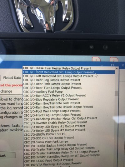

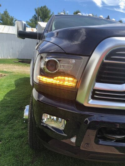

These the correct lights that should be on for DRLs with the projectors? Thanks!
1500ram12
Jan 23, 2012
5,487
2,432
2005
5.9L Cummins
These the correct lights that should be on for the projectors? Thanks!
Yes. Projectors use the parking lights at reduced power. If you turn on your parking lights you'll see they will be brighter
Cool thanks! Wanted the warm fuzzy I didn’t dork something up [emoji482]
