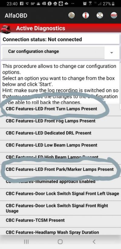

Ok, my next go around with Alfa is I want to try Profile Peak 3157 amber only LED turn signal bulbs in the front.
Just to make sure I keep this straight, go to Car Configuration Change menu and then choose:
CBC Features-LED Front Turn Lamps Present: and then go to Select value: "Yes" and then "Start "
CBC Features-LED Front Park/Mark Lamps Present: and then go to Select value: " Yes" and then "Start"
Correct
