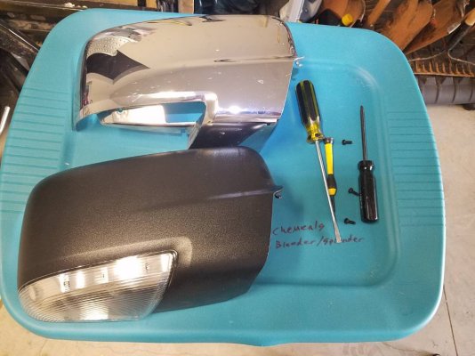

I know the non-tow mirrors can be taken apart and the "caps" can be removed. Not sure about the tow mirrors, though. The problem seems to be getting the glass off and back on without breaking it.
I would look for a set regardless of color and then have a shop wrap them in whatever color you want vinyl.
Thats what I did on my Laramie folding mirrors. (Disassembled and swapped the caps with a non power fold set.).

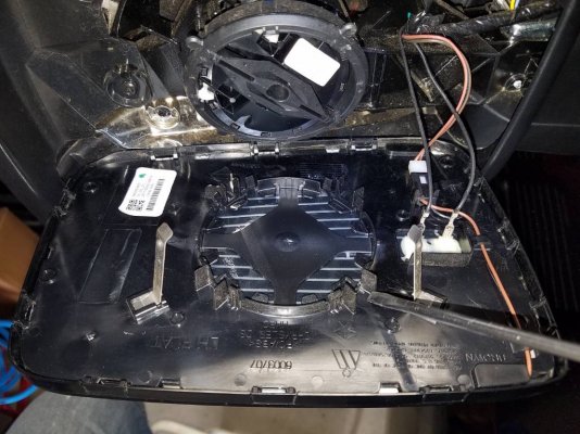

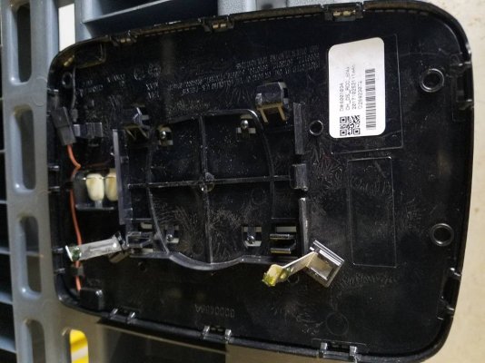

Any tips on getting the glass out without breaking it?
I need to do a thread for this (with standard power fold mirrors). I've got pictures I can email you along with some notes... Message me your email and I will send it your way.
Biggest issue on my 18 Laramie, was the driver's side glass attached one way ) tilted or from the top) and the passenger side glass attached a different way (req'd screwdriver inserted at correct spot to pop loose) so if don't adjust/ look behind the glass before you start you will break one thinking it comes out the same as the other.
Motor City Mechanic has a video for getting the glass/puddle lights out of the tow mirrors. Then dissasembly is pretty straightforward.
Biggest issue on my 18 Laramie, was the driver's side glass attached one way and the passenger side glass attached a different way so if don't adjust/ look behind the glass before you start you will break one thinking it comes out the same as the other.
M² Mods.
Thanks!
Sent you a PM.
