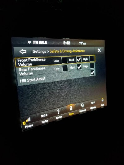

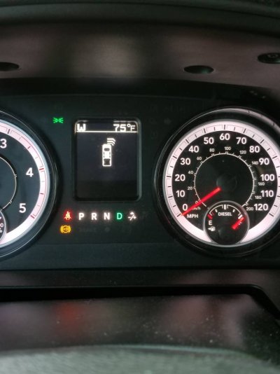

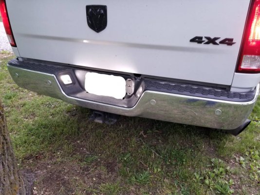

I can say I have successfully added OEM front Parksense to my 2017 Ram 2500 Tradesman today. I bought a front bumper from a gentleman with a 2016 Bighorn and he opted for a steel off-road bumper without reusing his sensors and left them in the bumper. I already had purchased the switch panel when I added the auxiliary switches so I just received my wiring harness for the front fog lights and sensors along with the front & rear Parksense module to replace my factory rear only pts module. All works great. Without even enabling my settings for front pts yet the display pops on on the 3.5" basic evic. Very satisfied. Just enabled the volume for front Parksense and the customer settings menu for front Parksense as well. We will see how long it takes to appear on my UAQ. Also the match the front chrome sensors I bought Chrysler bright silver paint and paint matched my factory black rear sensors which look identical now to the fronts. Blue connector is the extra connector used for the front Parksense.
