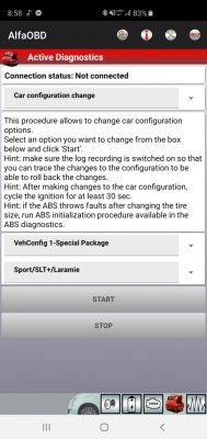

In the known working doc. Just replace the Limited with Sport.
EVIC Splash Screen (for Limited logo): (2015 to present trucks)
Vehicle Configuration 1: Special Package
Select "Limited"
Vehicle Configuration 2: Special Package
Select "Limited"
I have a 2014. I found 3 things under that section that say sport. There's Mopar/sport, sport, and sport/SLTScreenshot_20190508-085814_AlfaOBD.jpg +/laramie

@Falcon1772 Just "Sport" in both special packages worked when I was testing on my '16.

What does it do when you change it? Just a "sport" splash screen? I did the SRT one just for funsies
Ghost_RAM
Ghost_RAM
Jan 10, 2018
1,367
1,099
VA
SRT will not show up on the EVIC. It will say Sport on the EVIC display on startup only.
kad
Jul 10, 2017
2,788
2,331
Hudson Valley, NY
5.7L HEMI
I have a 2014. I found 3 things under that section that say sport. There's Mopar/sport, sport, and sport/SLTView attachment 165439 +/laramie
I am fairly certain, since I own a 2014 with the 7" EVIC out of another 2014 and have tried ALL the options, that the different splash screens only became an option in 2015. On 2014 and previous years setting them will either do nothing or cause it to show no splash screen at all. That's assuming your EVIC is factory or from another 2014. If your cluster is from a newer truck then it should work.

I put an 18 in my 14 and was able to change the splash screen. As kad: stated when I installed the 18 cluster it didn't show any splash screen until I enabled it in the special features but I could have Sport,Limited or whatever I wanted. The 14 premium cluster in my truck will only show the Ram emblem.
