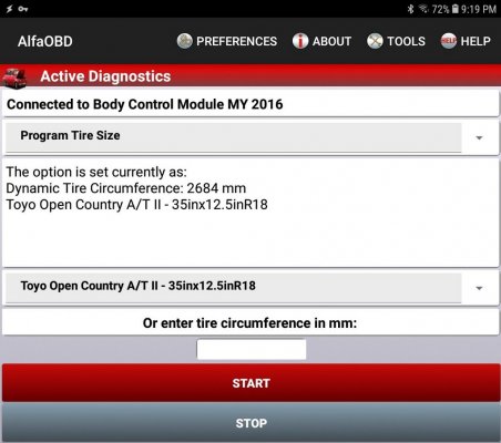

My 2014 with factory 20" wheels, running factory sized 275/60R20 tires (aka 33" tires) is already set at 2640. What wheels/tires was your 2016 equipped with from the factory?
-K
Hmmm...
I updated mine a while back when I put on 35's...
But checking my latest pull, I see the following:
Vehicle Config 4:
Dynamic Tire Circumference: 2640.00 mm
Vehicle Config 6:
Dynamic Tire Circumference Front: 65535 mm
Now, I updated by choosing a stock tire, the lone 35" tire listed in the drop down list - not by entering a custom number or anything. But it did correct my speedo, so I assumed it worked. Makes me want to double check now.

Yeah I saw that lol... OK I checked again I'm still set for Toyo 35's, 2684mm. So that 2640 stock setting must get overridden by the setting in Tire Control maybe...dunno. But my mph was ~3 mph off when I went from 33's to 35's and this change fixed that. I will say, sometimes it does seem like my odometer is racking up miles a little too fast, but I just figured it was my imagination. Maybe I need to do a 10 mile test on the expressway and see if it matches up with GPS.
-K
275/70-18.
