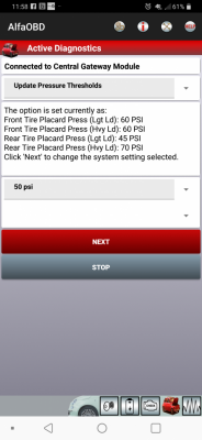

I cannot for the life of me figure out the settings for led lights. I've read all 695 pages on this thread and the 21 pages for the 06-12 thread.
I've got a 2011 2500, factory quads. Drls were already enabled.
I want to modify everything to run as an LED without resistors or harnesses.
According to the 06-12 thread, I just need to set the front lamps to HID, and change the DRL to led. When I go to set the option for HID, I hit the start button and next and get absolutely no input or output.
I'm using the 2.1.6.8 version of alfaobd, and I'm using a veepeak ELM327 capable Bluetooth module. No issues connecting or anything like that, and the module is exactly the same as the recommendation module.
No errors or anything like that.
Also had trouble with setting my tire pressure (see attached photos).
Any help is appreciated

mtnrider
Sep 25, 2014
3,538
4,300
Georgia
I would get the known working OBD module (OBDlink MX). He even mentions it on the site that not all ELM327 are created equal and the cheap ebay ones may or may not work. I'd be surprised if your $17 adapter has all the functionality of the $70 OBDLink MX.

Richmond2000
Jul 5, 2017
132
51
I bought the Veepeak elm327 and would get errors OR no confirmation when I would try programming with alpha and went and got the recommended MX and it works properly every option I try it takes and does NOT give error messages
the veepeak did NOT "break" anything but it would change the setting and never give the responce OR give an error response and the setting would not be set / could not be set
