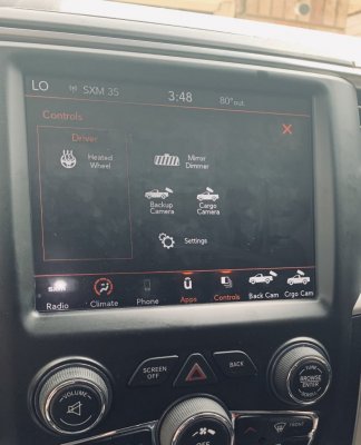

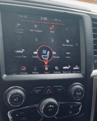

I have a 2016 Bighorn that started life with the 8.4" RA4 and standard seats. I added a UAS from a 2019 Classic and recently added heated/ventilated seats from a 2014 Laramie. I added the options in Alfa for them, however it looks like there might be something else going on. My "Controls" screen has resized the other icons to allow for seat controls, however the seat controls are not there. Is there something I am missing? I have attached the follow screens from start up. The drivers low speed vented seat turns on at startup like it is supposed to. These are the options I enabled:
Memory-Front Vented Seats Present
ECUConfig 3-Front Vented Seats Present
ECUConfig 3-Front Heated Seats Present
ECUConfig 3-Heated Steering Wheel Present
Memory-Rear Heated Seats Present
CustSetMenu 1-Auto-on driver comfort CSM (option 2-3)
Memory-Heated Steering Wheel Present
ECUConfig 4-Heated Seat Present
Memory-Heated Wheel Material Type
Memory-Heated Seat Material Type
Most likely because of the pre-2015 heated seat module being used doesn’t work with the UAS/UAQ radios. Might either need the infotainment module to make the soft keys show up, or a 2015+ heated seat module.
Is there a single module or is there one in each seat? I found Heated Seat Module - Mopar (68217268AF). Do you know if it would just be a matter of swapping this? It appears to be the same for both heated and vented.
There is only one module, and it’s for both heat and ventilated features. I would *think* just swapping them should do it, especially since you have a 2015+ truck.
Awesome. Is there one in each seat or one in the truck?
