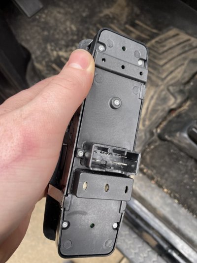

I know this maybe the wrong section/area but having there be over 1,000 pages there’s a lot to read. But I tired to read through some pages. I’m trying to put power fold mirrors on my truck. A 2016 Express. I bought the door modules and mirrors but i’m confused and don’t know what to do.
The factory window switch only has 1 connector and none of the power fold ones pins seems to match up at all with my current plug. Also what is the second PIN connection used for on the power fold modules? I’m stuck. I can’t seem to find a power fold module that matches my current pins. Any help would be appreciated!
The picture below is the pin style I have

Does your window switch have the power fold button between the L - R buttons?
Storm Tech
Oct 27, 2020
11
Broome
5.7L V8 Hemi
No, my factory control switch that came with the truck doesn’t have it. I am looking to order one with that for the new mirrors but can’t find the same pin connections

Pretty sure this thread has the correct part number
Storm Tech
Oct 27, 2020
11
Broome
5.7L V8 Hemi
I have not seen that thread before. I got the right part number off of that for the single connector. Thank you very much for posting that thread. I was able to find the one I need! Thank you!!!
