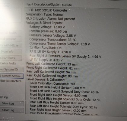

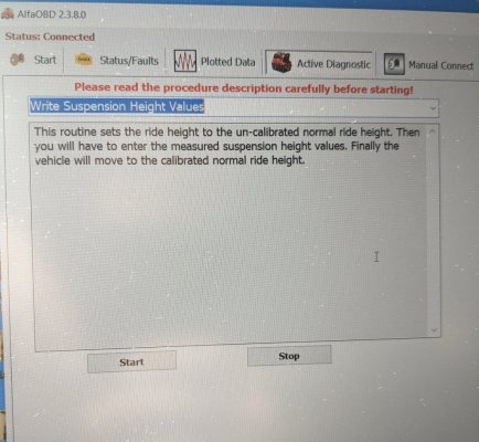

Hello all. I created an account because I have more of an AlfaOBD inquiry, relating to my Jeep Grand Cherokee (with air suspension). Apoloogies if this ****** anyone off, but our forums are light on info and the Ram forums seem to be very active around Alfa OBD. Georgeous trucks by the way. I looked into a RAM and a Tahoe 4 years ago but my driveway is too narrow and couldn't accommodate either of them.
So if anyone can chime in here is my inquiry:
I was wondering if someone can walk me through how to lower the air suspension settings (I want to lower my suspension about 10mm each corner). I was under the impression you can simply write in the new suspension values, but it seems this is a two-step process? Am I understanding that some manual measurements need to be made first, input and then we can set the calibrated ride height?
Some people say they just write the new values in. Others say they take physical measurements, pull up the offest values and then calculate the new numbers based off that.
I took some screenshots and did not proceed because I don't want to mess anything up. Thanks so much.
View attachment 521163View attachment 521164
One example
ihaveajeep
May 12, 2023
New York
3.6
One example
Thanks for this. Very helpful, and confirms there is more to it than just writing in new values. I might just pass o this mod. Maybe I'll just try and build some links. I'm looking for minimal lowering. Thank you.
