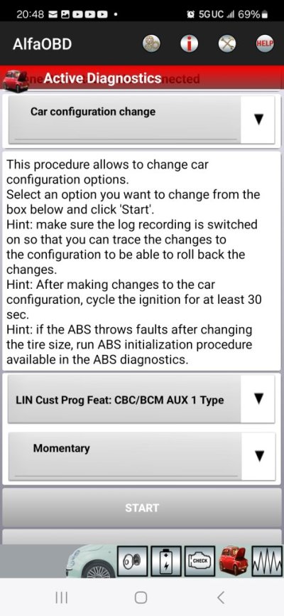

it's been a couple of years since i used my alfapbd. i tried to log into my truck to change one of the aux setting to momentary, but for the life of me i cant seem to get to/find that setting/section. anyone know what i need to log into?
any help would be greatly appreciated
18CrewDually
Nov 17, 2019
2,421
3,414
U.S.- New Jersey
Cummins 6.7 H.O.
Under the Body Computer, select Car Configuration Change, then select as shown below.
cityredneck
Sep 27, 2018
221
249
arlington, tx
thank you! i really wish i could get the aux features to show up in my cluster or radio, but ill take what i can get with it in the 1500. have a klienn on board air and horn setup using the aux switches. it works great!

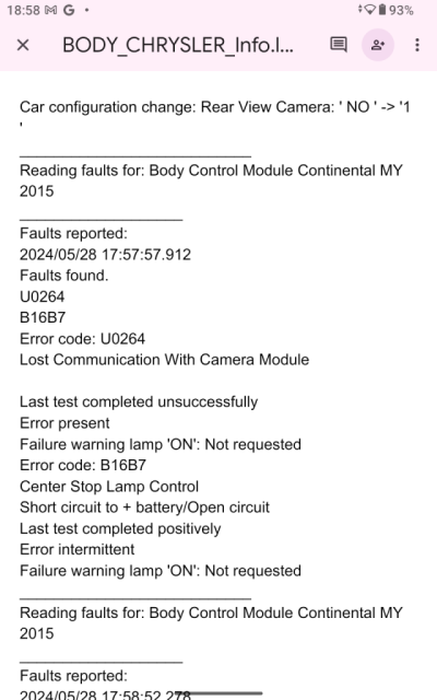

Hey guys. I’m having issues adding a oem factory tailgate back view cam to oem radio (GTRUI) all connection to that radio are ok in my opinion but got this error after checking engine on alphaobd
B16b7 is because of rain I think, but is not showing up on my dashboard dunno why, because when lat time I was washing my car had b16b7, probably that third brake washer?
