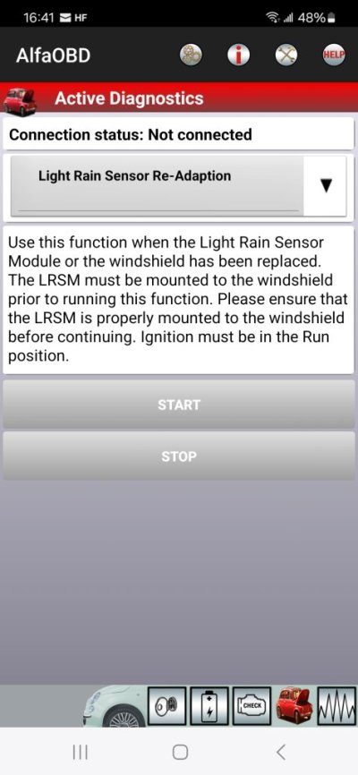

Had my windshield replaced and the auto wipers aren’t as sensitive as they used to be by quite a lot (2017 ram 1500 Laramie). I saw a few posts on people adding the rain sensor and enabling it via AlfaOBD, and some mentioned calibration settings.
Is there a way to calibrate the sensor with AlfaOBD?
Has anyone tried that out?
Under BCM AND Configuration.
