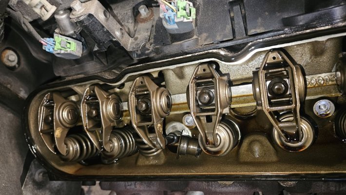

I have a Denali 6.2L with the cyl. deactivation and it shows on the cluster when it drops to 6, or 4 cyls. So far had 1 lifter fail collapsed. That resulted in a broken valve spring, torn stem seal, and bent valve. I got super lucky and didn't have to swap the cam since it was not a roller failure but I did remove the head of course. New valve lapped in, new guide seal, new lifters (8), head gasket, & head bolts and it was running that afternoon. I got lucky. But still hate the system.
Sorry in again for the GM content but here's couple of pics.
Pulling the valve cover, this is what I found.
Upon removal the culprit lifter pulled apart in my hands. All the others were fine but I replaced them anyways. The valve was bent from bouncing off the top of the piston. No damage there luckily.

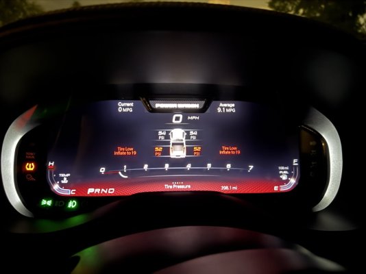

Just finished performing the Update TPMS Threshold on a 2024 PW. It appears to have taken, but my TPMS light is still on. Display shows the corrected PSI. Anyone seen this before?IMG_1133.jpeg

Just finished performing the Update TPMS Threshold on a 2024 PW. It appears to have taken, but my TPMS light is still on. Display shows the corrected PSI. Anyone seen this before?View attachment 547796
Under VehConfig 3: I have the following in my 16:
Max Load Inflation Pressure Rear Tire (0‐126PSI): 39.000 PSI
Max Load Inflation Pressure Front Tire (0‐126PSI): 39.000 PSI
Light Load Inflation Pressure Rear Tire (0‐126PSI): 0.000 PSI
Light Load Inflation Pressure Front Tire (0‐126PSI): 0.000 PSI
Have you changed the max to something like 60? I think you are getting the alarm and low air because you are way out of range for what it wants to see vs: the actual.
