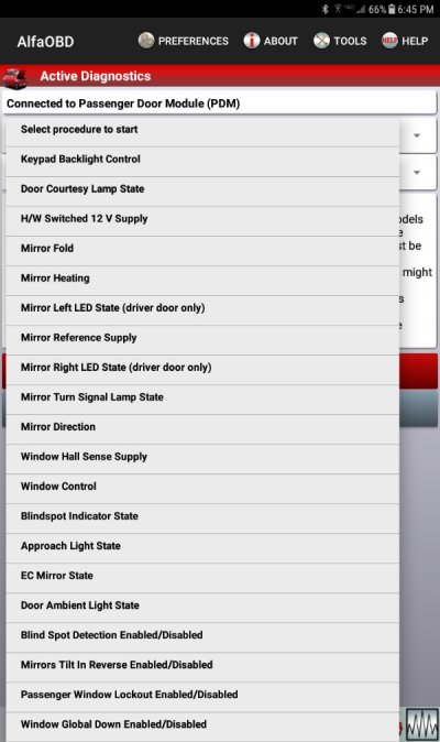

I have a 14 ram, with the aux switches. The first one is already used, I don’t remember by what. Also looking in the BCM configuration file for my truck shows auxiliary switches csm: switch 2-5 option. Don’t know if their are more options
I have the option for 1-4 or 2-5 HOWEVER if I go to PTO switch settings or something along the times of that I can choose the option for 5 auxiliary switches.

Here I thought these settings were only for testing the installed features.
I can't seem to find that option anywhere except in the window module I just did the fog drop out

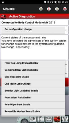

That's interesting. We both have the same year. Fog dropout and Global up/down are both located in my BCM.
You happen to have a picture of what's close to I've skimmed the whole thing but maybe I'm just blind....

I was able to do the fog lights the global down windows is what I can't find the only place I can find it is in the door modules and it won't load from there
I edited my post to include a link to a few posts above yours.
