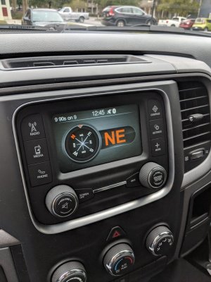

I just got the compass module working.
Show compass heading
Select yes
Compass mounting orientation
Select right side up
EOM presant
Select yes
Compass variance
Select yes
Compass calibration
Select yes
Select yes
EOM presant
Select yes
Compass variance
Select yes
Compass calibration
Select yes
That's great to hear! I think your the first one who has actually installed the compass and used the tool to set the codes. The next thing to try might be for someone whose truck came with the RA1 radio with no overhead console to install the Homelink and wiring and see if we can figure that one out as well.
My truck originally had a UA1 and no overhead console. i put a homelink module in my 95 Intrepid a few years back and IIRC all it neede was a power and ground, so i would think these would be no different.
I just went for a drive, and after driving in a circle to get it calabrated it works perfect siting on he steering column in front of the gauges. I was planning on making a longer harness, and sticking it inside the headliner cause I dont plan on using the stock overhead console. Now I think ill mount it in the dash behind the guages and see how it works.
It will need the code enabled in order for the commands to show up on the EVIC. I know in the factory configuration it will not work unless the code is enabled. I guess it may work if you just wire it to hot and ground without adding the codes and it just wont show transmitting or training in the EVIC. The module itself has three pins. I'm assuming one ground one hot and the other for the CAN/BCM. I'm not sure if it would be able to illuminate it at night. Not sure if anyone had tryed just hotwiring it in. I'm curious to see how it were works for you. Let us know how it goes.
