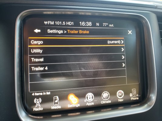

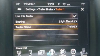

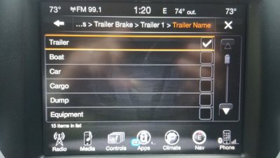

Trailer Name Settings:
I had not seen this covered (but could have missed it since this thread is getting huge) but I know in some of the early 4th gen HD trucks you had the ability to re-name the trailer brake slots at the evic to put a custom name in there so you knew which trailer the settings were for etc. My 2016 with the uconnect 8.4 and premium EVIC just had them named trailer 1, 2 etc in the uconnect settings with no way to change them.
I found this setting in my log "Trailer name customer settings menu: Not set" so I thought I would change it to see what happened. Under the Car configuration change menu there is a Trailer Name CSM setting and I changed it to yes (was no).
When I initially changed it it threw some sort of error and basically seemed to crash. I was not able to grab a screen shot or any other info so today I thought I would try and recreate it. When I went to the setting it now said "yes" so apparently it did change it even though it kicked some sort of error message.
While I can't add custom names it now allows me a list to choose from. Better then having them all named trailer 1, 2 etc. Pretty happy about this little mod since I have multiple trailers.
why they don't have this enabled from the factory is beyond me? It's there why not use it.
I had not seen this covered (but could have missed it since this thread is getting huge) but I know in some of the early 4th gen HD trucks you had the ability to re-name the trailer brake slots at the evic to put a custom name in there so you knew which trailer the settings were for etc. My 2016 just had them named trailer 1, 2 etc in the uconnect settings with no way to change them.
View attachment 144433 View attachment 144434

Factory. And I have searched and searched and have yet to find someone that was able to change the trailer name with the 8.4 Uconnect? Everyone complains about it because it says you can do it in the manual?
That’s strange. My 2017 has factory controller and came with the 5.0 radio, and the trailer names were there. I have since had 2 aftermarket radios with the maestro, and the names show up in both of them. I’ve never had an 8.4 radio in there to try, though.

I can confirm that my 2016 2500 with factory trailer brake controller and 8.4 nav also didn't have the trailer name csm active. I turned it on with alfa as well and it works like the manual states. You do have to have the particular trailer preset active to change the name.
I just went out and checked mine. The naming option is there as predicted by the BCM setting.
I also went through the BCMs in the shared drive:
14 - (mine) Naming option set (is also set for integrated brake controller)
15 - Not set (but also not set for integrated brake controller)
16 - Not set (but also not set for integrated brake controller)
17 - Not set (but is set for integrated brake controller)
18 - Not set (but also not set for integrated brake controller)
The only thing I can't tell is if the '17 had the controller from the factory or if it was added later and the option added or set with AE or Alpha. I know mine was factory.
Yours seems to have been in the same situation as the '17.
The only difference I can think of for mine is that up until yesterday, I had the RA2 radio. I just put an RA4 in yesterday.

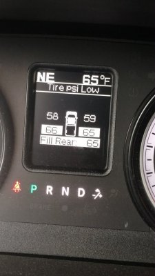

Ok, so I have set my DRL's to the turn signals and they work.
Adjusted my TPME threshold and it shows changed and my idiot light is off, but the screen still pops up and shows the back tires are low. Any ideas of something I need to change?
Edit:Forgot to add, I did flash/reset rfhub too
Just changing the threshold won't do the trick. There's a whole procedure to go through and you'll need your trucks RF Hub pin # from the dealer. The procedure is detailed in the TPMS.pdf file on the Info_Issues folder on the shared drive (see first post).
-K
It's really looking like it's only an issue/missing with the 8.4 factory installed radios and premium EVIC from what I am seeing?
