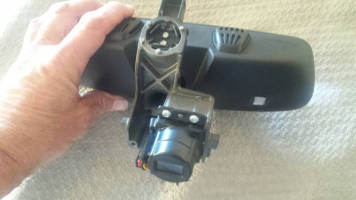

Any Auto High Beam mirror should be Auto Dim as well. The light sensor for the Auto Dim works in coordination with Auto High Beam. I see the auto dimming mirrors listed incorrectly all the time on eBay saying their Auto High Beam when they are not. This is a picture of a Auto Dim/Auto High Beam mirror for the 13 to 16 Ram with the plastic mirror cover removed. If you are wanting to add Auto High Beams to your truck this is the mirror you need. If it does not have this camera lens type setup on it is not an auto high beam85ee4b72c47905b903eb1fbf795dde56.jpg

I’m pretty sure that camera looking thing is the sensor for the rain sensing wipers. The little white square should be the sensor for the smart/auto high beam. The auto dim sensor is the little circle facing you in the top center on the mirror face.
That is incorrect. The small white lense is for the Auto Dim feature only and not the Smart Beam feature. The camera looking lense is actually for the auto high beam and detects light sources from the front of the vehicle and adjust the headlights accordingly. It does work in conjunction with auto dim feature as it adjusts the speed at which your Auto High Beam feature will function by detecting the amount of ambient light present. The small little circle that's actually on the face of the mirror detects headlights behind you and activates your auto dim mirror when the little white square on the front of the mirror detects the ambient light source is low enough for it to function. I only know this because when I did mine I thought exactly what you are thinking until 00/RT sent me a link to the correct mirror and explained the difference to me.

That is incorrect.
Rick is correct. D@mn junk yards :)
This is what the mirror looks like with BOTH the SmartBeam Sensor (clear window in the mirror cover/cup) and Rain Sensing Wiper feature (the darker black square in the windshield tint).

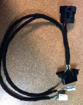

PS: if you have a 2018 Ram, you need to bypass the security module using our Bypass harness to be able to connect to the BCM with any scan tool (except the dealer's).
2018 RAM Security Module Bypass.
M² Mods.
1) How do I purchase this harness and how does it install?
2) I have an OBDlink MX WiFi model. Will it work as well? This was the unit I used in my F-150 with Forscan, the Ford version of this tool.
@deereguy can make you the bypass harness if he still has parts. Send him a pm with your name/email so he can send you details.
My guess is the OBDlink MX wifi will also work... Have you checked to see if it's listed on the Alfaobd site?

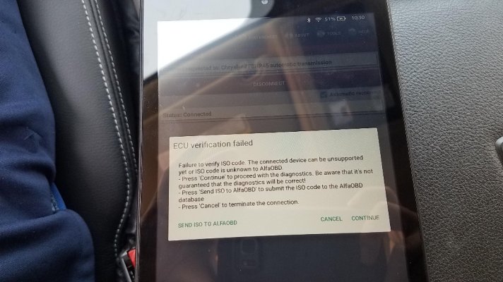

This made me jump outta the driver seat!
I have a zf8hp70 not the 45, the alfa connected using the zf8hp45 protocol (does not have a 70 - also my truck is a 17 but when connected it says i connect to MY16 body module), but when trying to pull info i got that.
Is that a common warning, or do you guys think i coulda bricked the tranny control module?
I unplugged and started my truck and decided to come inside now lol
