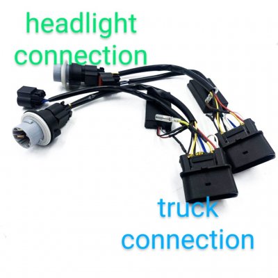

Thanks for advice. The adapter they sell for projector type headlight( as per picture) is different. The plugs are different from actual factory headlights. Thats why i am bit confused.
Since your truck already has the factory projectors, as mentioned order the adapter with the new headlights.
That adapter looks like this:
(the respective connections are noted)
You'll also wire the DRL connections to these adapters.

The pictures on their website are generic. The connections will work for your vehicle.
