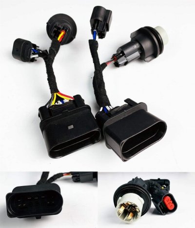

I haven't pulled the trigger yet, but here is what the harness looks like. I'm just wondering if activating the DRL options in alfaOBD would actually put voltage through the wiring on my connector, enough to activate the DRL's on the headlights properly

Since your truck came with factory projectors the dedicated drl feed is already enabled. That feed used the park/turn lights but has its own feed to them. Comparing the pics of the harness included they haven't added the dedicated drl feed to the harness yet. That's something you'd have to add to each harness. I'm not sure if anyone has found just the pins for the oem projector connector yet. You can buy the complete connector and pins off of Amazon.
https://www.amazon.com/gp/product/B07LD58C9B/ref=ppx_yo_dt_b_asin_title_o03_s00?ie=UTF8&psc=1
Then all you would have to do is take the wires from the drl harness that comes with the lights and use that to add the feed into their harness
