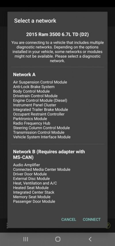

So it looks like in order for me to see the driver door module, i need the Adapter for the Network b with the MS Can. Is that the adapter thing for the 2018+ models. The Double bypass? It cleared the code but im patiently waiting for it to pop back on like it did when the Oriellys guy cleared it with their machine. It said it was permanent on his and looks like it says the same thing on this one. Any suggestions?

You need to use AlfaOBD. It’s an app in the google play store or software download for windows. You also need a security gateway bypass. All the info on AlfaOBD is in multiple threads that can be found on this forum.
Roger that, so this app will work with the OBD Link MX+ blue tooth one?

Forget the bypass. I forgot you have a 2015, you don’t need one. You’re good to go with the MX+ and AlfaOBD
