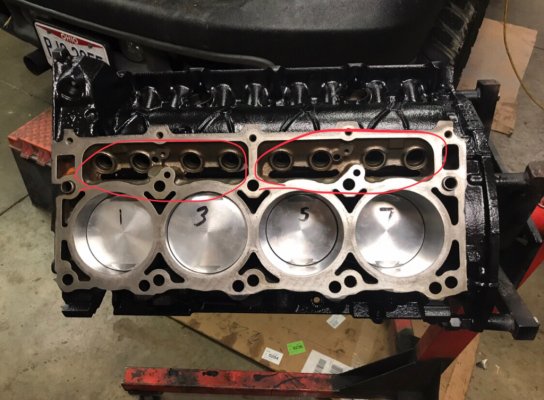

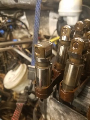

Here's another one for the masses. 2011 Ram 2500 5.7 with 151000 miles. All of the previously posted symptoms. P0302, changed plugs, coil and injector with no joy. I decided to go ahead and change the cam and lifters. Glad I did. #2 cylinder lifter took a poop and killed the cam as well.

Thanks. It was bound to happen. Bought the truck with 147000 miles. Also, I forgot to mention that I run AMSOIL 5W30 for 2 oil changes then used 5w20 about a week before this happened. Not saying the 5w20 was the cause but it definitely expedited the process. Truck ran fine with the 5w30. I'll be switching to PUP after this gaggle.

I had a lifter fail in an '03 Pontiac Grand Am (3.4L V6) a few years ago. Tore the engine down, dropped the oil pan, checked the cam and it was OK... so we slapped in a new set of lifters and buttoned her back up. Car was still running strong when I sold it to a coworker year later... and as far as I know it's still running today.
Looking at the OP's pics, if a lifter fails it's going to eat that lobe on the cam. BUT if you replace before one fails the cam shouldn't be damaged. That's what has me thinking along those lines. Would be much easier (and cheaper) to replace the lifters at 100,000 and head off a problem like this than to have one go on the other side of 100,000 and need to replace the cam as well.

I'm not an expert on this engine yet, but from the pics I've seen of failed lifters and eaten up cams it seems to me that the roller on the bottom of the lifter is the point of failure. When that collapses and stops rolling the body of the lifter then makes contact with the cam, which chews it up. The cam is just a shaped metal rod, not really anything there to fail short of it just breaking.
