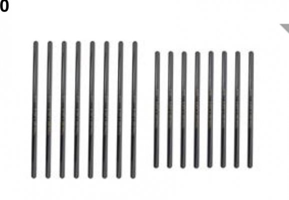

Question. Is it a fact that our push rods are a different length on the exhaust valve versus the intake valve?
Yes they are different. And the 5.7 pushrods are a different length then the 6.1, the 6.1 rod’s are about .125” longer
