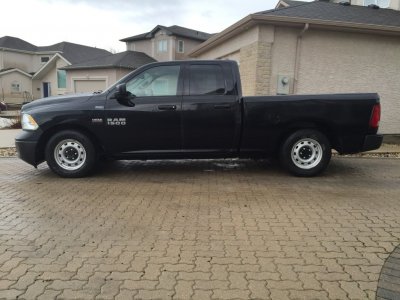

Here’s a picture of my ‘14 , 2/4 Belltech, with 17’s the day I traded it in at the dealership
It definitely looked unique
30.5” snow tires on the rims
Truck had 3.92’s, lightweight steel rims, 66lbs- had lots of performance compared to the heavier, taller tires
I know this is not what you want, but IMO it didn’t look awful...3F2E8BCF-8FA4-473A-AB53-C2D9C79D3954.jpeg

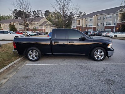

Here is mine on the stock 20s with 275/55-20 and cut coils on the bell tech kit so a lot closer to 3-5 now. If you go to https://tiresize.com/calculator/ and play around with different sizes, probably want to find something around 32 inches for diameter. Stock size on the 20s was 33 and I did get a little rub on hard bumps after I cut the coils down.
