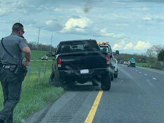

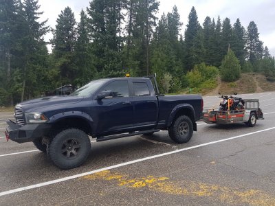

Unfortunately this happened to me Sunday. Approximately 2000 miles and zero offroad on my BDS control arms.
State trooper told me there was at least 300 feet of skid mark about 2 feet away from the guard rail...yep...I was there for that.

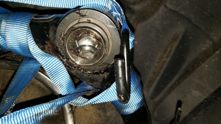

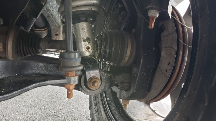

I sent all these photos to BDS. Their tech support tells me their control arms are not recommended for their 4" lift kits. Not the same thing the sales person told me when I was convinced to buy them. Bottom line I am paying out of pocket to replace the tire, cv axle, abs sensor, tie rod end, sway bar end link, and possibly a lower ball joint. Tech support was only willing to cover their parts so I'm being sent more crappy Moog "Problem Causer" ball joints.
I was told using the Fox 2.0 coilover shocks with the 4" lift and it's required spacers has not been tested by them so they wouldn't accept liability for their product failure. No Fine Print warranty my ass! He told me their 4" lift kit is based on using stock struts. I asked what's the difference since the fox shocks were set to factory height per the instructions and going back to factory struts I'd still have the same height issues and angles on the control arms. No response. The shop that did my install is just as shocked by BDS and their response. My shop recommended we raise the front an inch to decrease the angle of the control arms and go to 3 inch spacers in the rear to keep it level. After seeing how others of you out there have the 6" lift and suffered the same failure you'd think BDS would realize there's a serious problem with the ball joints they are using!
It's very aggravating that BDS won't step up for their product failure and how this could have been a far worse situation...potentially life ending! Of course my setup was going to work fine when I was convinced to make the purchase of their control arms, but now that something has seriously gone wrong they are back tracking with quickness. Say anything to make the sale...then find any reason not to honor up to collateral damage cause by a failure of their parts.
Shout out to the tow driver that got me from Gettysburg to Dillsburg where I was able to get the replacement ball joint and to the AAA tow driver that got me all the way back to WB. I was able to get the ball joint replaced Sunday night and had to order a new abs sensor from Amazon since it wasn't available locally at 1/8 the price. My shop got the new tire in this afternoon along with the replacement cv shaft so I'm setting up to bring it to them Thursday morning.
If anyone has recommendations of control arms that I can trust...please share. Worried about the passenger side ball joint just going "snap" on me at any time like this one did. No excuse for this failure with such low miles after a month.
