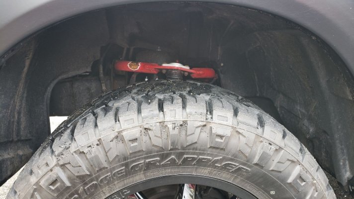

View attachment 245072 The JBA upper control arms are good. I have them. They make their own balljoints and I think they’re one of the best balljoints out there. A lesser quality balljoint can be bought at any auto parts store and will fit the UCA. It’s convenient, but I do not anticipate ever having a issue with them.
If you’re not a fan of the gloss red they come in, I wasn’t, you can have them powder coated at your local shop for about $40. I went with black.
https://jbaoffroad.com/jba-a-arms/ram-1500-uca.html
I had them before I got the BDS control arms. I would have kept them, but JBA told me their control arms are for factory spindles and stock to leveled height. They couldn't say if it would work with the BDS spindles since they never tested it that way.
Here's what it looked like when I had the JBA UCAs on the BDS spindles.

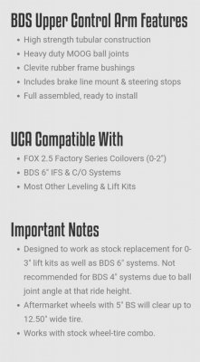

Found this on there website.
Not sure when they updated it.
I can tell you that they "DID NOT" have that posted anywhere on their site before ... that is new and they did it because of all the failures to the UCAs as of late ..... complete bs if you ask me lol ....
I believe you 100% I'm just throwing it out there for the guy who is still running the 4" kit with the misalignment ball joints right now. It's a PSA to the point we don't want others suffering the same fate.
Oh yeah my friend never assumed you didn't ..... things are getting very interesting I can tell you that ....
What he said. Interesting how this magically appeared after what happened to me! I saw they added this to their website yesterday. I still have the screen shot of the components their sales person configured in my cart back in February which included their control arms. Looks like they got free R&D at my expense!
Was it on the packaging or installation instructions? If not I think you'd have a case with them. I'd be fuming if the only compensation offered was new product.
Funny the say it won't work with 4" but 0-3". Wouldn't 0" have the same angles as 4"?
Lol.
Plus the BJ is popping with 6" just like it did with the 4" in this case. What a POS excuse for a defective product.
They're trying to cover their backs. No fine print warrant BDS? They're a joke.
