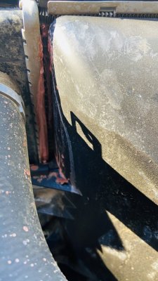

For years I hear everyone claiming they smell antifreeze , yet we can never find the leak. I used gunk foaming engine degreaser and never washed it off. 2 weeks later I look and you can see where it leaked , the dye in the antifreeze contrasted with the dry engine degreaser. A3BCC468-A89A-4DE2-AAFD-0E4EA7DBE08E.jpegA3BCC468-A89A-4DE2-AAFD-0E4EA7DBE08E.jpeg

That sucks. At least a radiator is pretty easy to R&R.

For years I hear everyone claiming they smell antifreeze , yet we can never find the leak. I used gunk foaming engine degreaser and never washed it off. 2 weeks later I look and you can see where it leaked , the dye in the antifreeze contrasted with the dry engine degreaser. View attachment 194437View attachment 194437
Some of the best inventions in the world, were made by mistake. Pretty neat fix there.

Man thats great to know, I've always sprayed it on use a Stiff bristle brush and hosed it off, Thank You for sharing!!!
