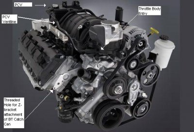

Okay folks, here is a picture of the involved components and where you attach the single bolt. Hemi showing PCV vent.JPG :weld:
The can has its own hose to run from the PCV to the inlet on the can, and another to run from the outlet to the point at which the previous PCV line enters the intake.
The single bolt goes where noted. The most complicated part of the install, and I'm not saying its complicated at all, :shakehead: is removing the air intake and your engine cover first. :angry94:

So just to be sure, the catch can goes between the pcv and throttle body inlet?
The throttle body pointed upward weirded me out, only seen them facing forward
The catch can attaches at the front right side of the block. Hoses from the catch can route PCV outlet to can, and can outlet to manifold.
TB only channels air, unlike a carburetor, so could be sideways, pointing up or upside down :insane:
