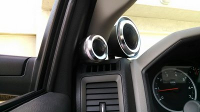

I ran the Hertz Hi-Energy 3 ways on my first build, they sounded awesome! Like you said, everything fits in the truck pretty easily. I tried the tweets on and off axis and off axis sounded much better, IMO.
My second build was also 3 way, but active and a little more elaborate... ;)
