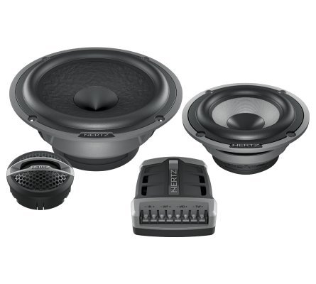

I installed the Hertz Hi-Energy 3 way system in my Ram and they sound great.
Link
The 3" midrange fit easily in the dash positions with the tweeters in the sail panels. The midbass drivers went in the doors.
Link
TomT
I second the Hertz speakers as one of the very best midbass speakers made today
