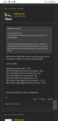

@Thunder240 Hey bud, a couple weeks ago I was in your exact position. I bought the G2 from Alpharex directly. Currently I'm running a 35w innovited HID kit 6000k in the lows, Katana LED in the highs. There wasn't any fitment issues whatsoever. The only issue I had in the whole process was a "Parking Lamp Out" error whenever I hit my turn signal.
Tonight in fact, i finally used Alfaobd to correct the issue which involved turning on HID. Setting LED for highs and lows to no, LED Parking/Markers to no, LED Front Turn Lamps to yes, and change the voltages for front left and right corners from 13.0 to 12.2v and same for headlamps and low beams as well.
Overall very happy with these lights for th $384 I paid.
