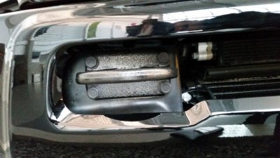

There are brackets to raise the bumpers, right? What do you do with the tow hooks after you install the body lift?
Yes there are. My tow hooks are sitting in the shop collecting dust! I want to do something like this on my truck though. These are off the new 2500's
xrsman
Sep 9, 2013
4,473
1,319
Ontario
3.0 Ecodiesel
