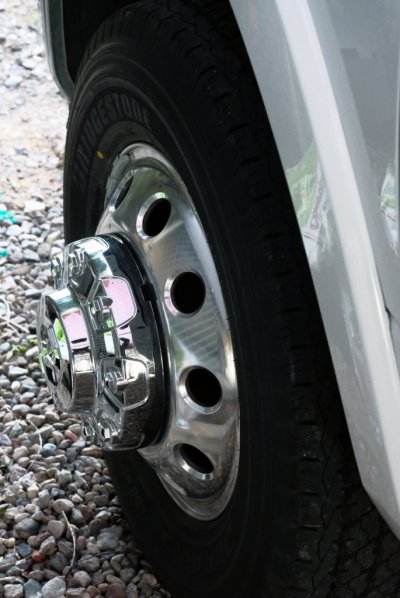

tif, here, below are those Bridgestones you recommended mounted on my front wheels! Got them on Wednesday 2/8 at Discount Tire. After being installed, I tracked my mpg on my 120 mile loop home from Phoenix and I averaged 2 mpg more w/ these, -- and with the .05 - 0 toe in alignment you suggested. Thanks so very much !!​
