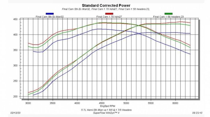

Dyno sheet with 1 7/8 ARH headers, vararam, moes ptb, hemifever tune.
Need to get a dyno and track time with the cammed 6.4 srt motor I swapped in

When I have time I'll have to search his channel more. The 1st couple I checked out are on motors that are cammed for higher rpm hp which would makes sense for the 1-7/8" to make more power. I really wanna see a stock engine with stock cam and how they compare. As the few scenarios I have seen show the 1-7/8" doesnt pay for a truck that will be used as a daily and may tow. The lower end tq loss isnt worth the smaller peak hp.
I will check his channel out and try to find different results. I have watched his vids before. Good channel

Couple of things got me in this article after rereading it. The dyno graph shows 1 7/8 final header dyno which is a typo. They are intact 1 3/4 headers vs 1 5/8.
