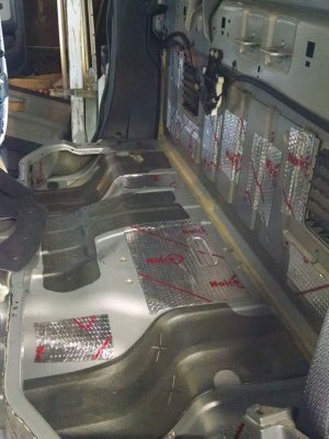

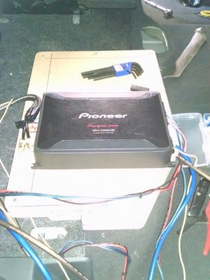

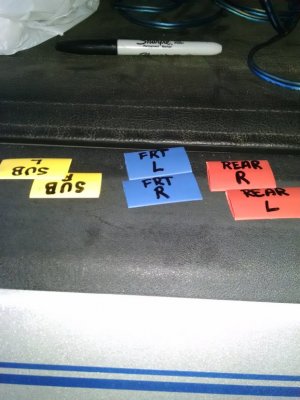

Some pics of my build

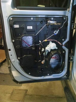

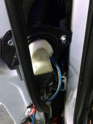

More pics. Added foam baffles to all speakers. Had to add spacer rings in the doors for the 6x9s to fit right then put foam weatherstripping around speakers.

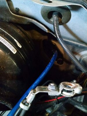

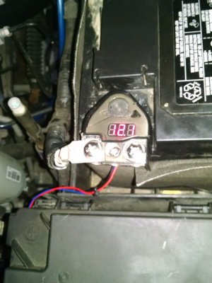

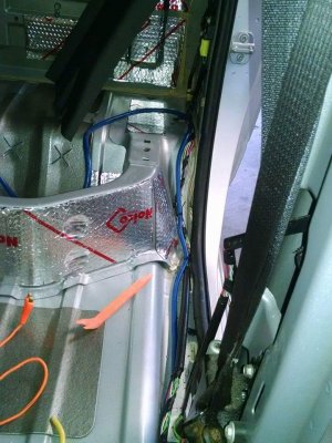

Tied in a mini 100 amp ANL fuse & holder. I don't have pics but all wires and cables are techflexed and zip tied to existing factory loom.
