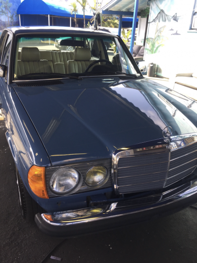

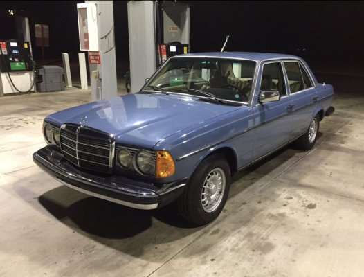

I’ve got an old 83’ Mercedes 300D Turbo- Diesel in my collection.
It is common practice, and recommended to actually do just that., and a quart of ATF to a tank once in a while. Reason was, and time has proved correctly that it would actually clean out the mechanical injectors.
Doing so on a Current era Diesel….. I’d have to get a lot more info on that before doing so. Are clogged injectors an issue still?
While we’re on it, for the same W123 Mercedes, if you ever found yourself low on gas and there’s no diesel around….. you could use regular and add a few quarts of oil to the tank. These engines will run on anything. Temps will run a bit hotter, but keep in mind of the situation your in.
There’s a reason its not uncommon to see over a million miles on these cars :waytogo:

Looks like a Gray Market Mercedes. I rode in many a 300D Mercedes Cab or Opel in Germany. I had a 1974 Mercedes 280 SL (gas 6 cylinder/2 carb) sedan in Germany, my last car before PCS back to states. Even tho Diesel Kleen allegedly helped pump lubrication, I ran it mainly to boost cetane level in MY 2015 ED (Gen 2 ED), friggin diesel pumps in Texas at fuel pumps (not sure ref Truck Service Centers on Interstate, tho I think the same), are all biodiesel.
SOCAL: As U well know , U keep up the MX on them old Diesels, them rides run forever. Never get that type of life outta a New Diesel Now, IMHO.
That is so true. Be it quality control, pride of workmanship, and materials used. Just like Mercedes ads…. It’s just not how fast you go in the quarter mile,….. but also going beyond a quarter century :waytogo:
By far one of the most favorite cars. This one was originally delivered to Beverly Hills Mercedes in 1983. California car all it’s life.
