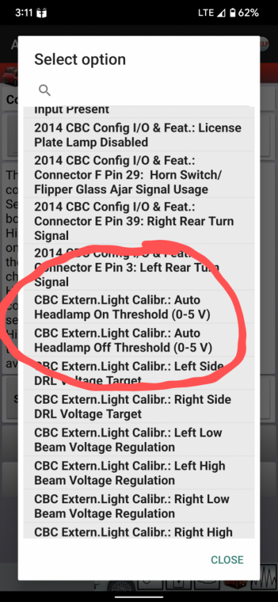

It can be changed in alphaobd. That's just the way they are
Do you happen to know where to find the sensitivity setting? I have used the Alpha OBD to change my TPMS and a few other settings already.

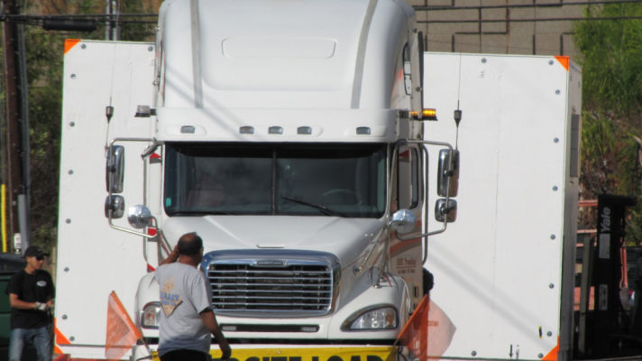

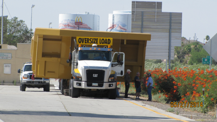

I ESC0RT semi trucks that are hauling extra wide loads
