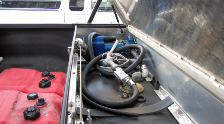

Gasoline Aux Tank
Connects to fuel filler neck
Gasoline needs too be pumped from the *top* of the tank unlike diesel which can be gravity fed.
Description provides information on getting a pump set up.

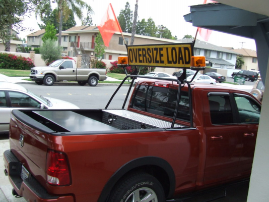

For 7 years, i had a 30 gallon Transfer Fuel Tank with its own electric pump & gas station type nozzle.
It would pump 5 GPM
In all the Rams tank was 32 gallons
The Transfer Tank was 30
i also carried Three 6 gallon plastic jugs
80 Gallons
The trucks tank would get me around 350 miles more or less, we were going about 57 mph.
The semi truck driver would stop & check his tires the load chains or straps, i would transfer gas from the transfer tank to the main tank & we would continue on to the next stop, which was about 200 miles, where i would top off my tanks, so i could follow the semi truck to the final destination, which was the Oakland Airport
We made several of those trips.
with the eco-diesel, i can travel the same distance on the main tank
I carry the 3 plastic jugs, just in case
