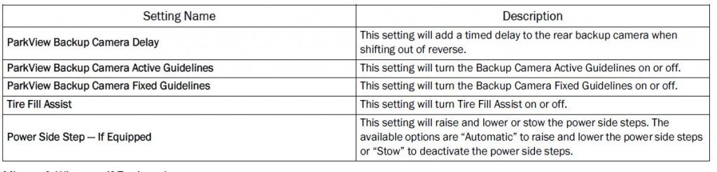

Somebody needs to chime in that has a High End truck with the surround system. I cannot help, lowly Bighorn. There is a setting in U Connect to change the lines, but my programming prob different than your high end limited. From 2021 Manual: best I can find, after this chapter, there are a lot of Safety Settings Also. This is all in your settings under U Connect settings.

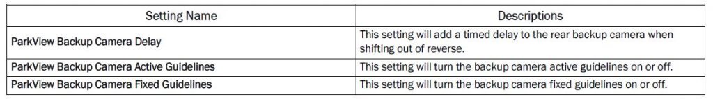

Look under Settings, Camera on the radio that you can turn the guidelines On/Off along with making them Fixed.

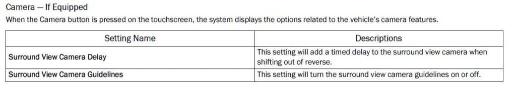

It's not under the camera settings, just gives me options for the surround camera as snipped above. That's exactly where I thought it would be.

Well, that came out of a 2021 manual. Hold on, lemme look and patch in the next set of Safety, may be there maybe, with different trim levels and more than I have (lowly Bighorn), who knows: SAFETY/driving assistance: LOOK BELOW, shows in here also... Maybe posted different place like here due to trim level.
May help U to download yer manual, multiple places U can. I cannot post the manual for U, it is 30 mb, way past forum allowances.

He has a limited, and those controls I found posted in Safety/Driving U connect settings also. Hard to help sometimes when PPL have a Newer/Higher trim level than my poor lowly Bighorn Driveway Princess, lmao... :33::angels2::anitoof::gunner:

Well, go in and change the setting. LOL... I posted the 2 places in U Connect that has the options that you can enable/disable the function. If that does not work, then dunno. If I go into U connect and disable mine, the lines do not move, so my only thought is see what I posted and try again.
I would be scared to go to dealer, even with warranty, and state this problem, and they go in and ***** yer radio, just saying.

Appreciate it man. I don't have the same options under those settings. I did look through the manual but couldn't get it figured. I'm going to swing by a local dealer on the way home and see what they say. If I get a solution, I'll post it here. Thanks!
