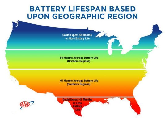

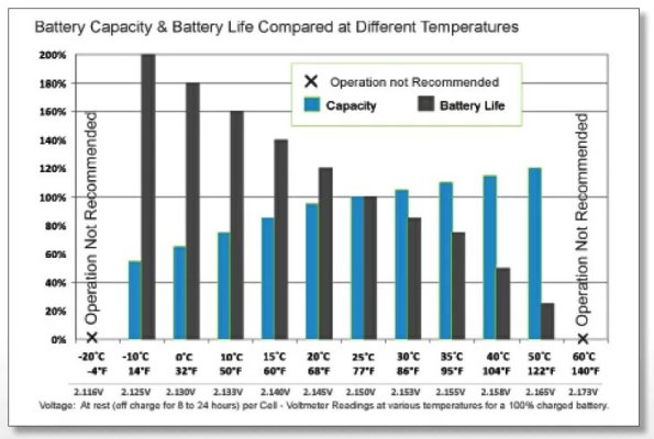

Lifespan versus capacity, a smart guy would maybe try and bump up his capacity a bit by going h8 in cold regions and take advantage of the cold life span?

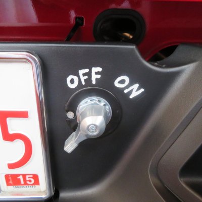

I doubt you'll have any issues.I used to disconnect the batteries in both my truck and in both the wifes 16 and 19 Challengers all the time,and never once did i have any issues.The 1320 Challenger would have to sit for an hour with-out cycling the key to get the "Drag" pages back,but that was it,the 16 had everything come back as soon as the battery was reconnected,except the equalizer settings,i'd have to reset those. My 300 right now is sitting with the battery disconnected,and the only thing i'll have to reset will be the radio's equalizer settings,and it's analog clock.

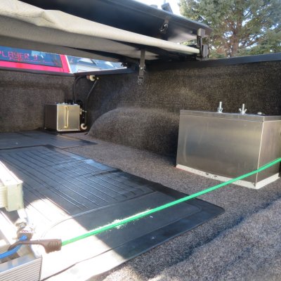

Hell my truck used to get the battery disconnected every weekend,as i ran a relocated battery in it,and one of NHRA's rules is you need a easily accessable master disconnect switch that shuts the truck down when it's running,and it got checked on a weekly basis.

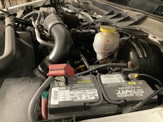

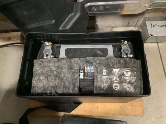

image.jpgimage.jpgI replaced the 19s battery in march.It was fine but I’ve always done 4 years the old battery sits in a battery box on a trickle charger so I can use it on trips where the freezer is in the back.Its fused and wired in to the main #2 copper winch wiring that goes to the bumper.It works,but honestly it’s still good.
