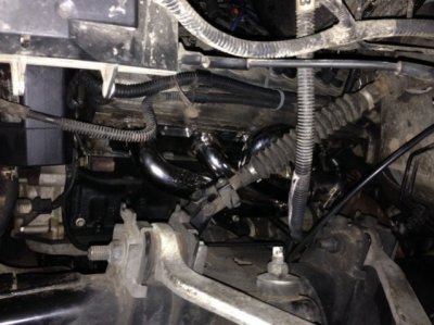

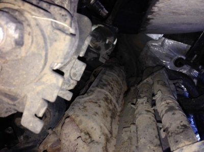

first two are the passenger side the other two are the drivers side
if they are bad pics i can try to get better ones
thanks again

That steering knuckle looks to be a touch close is my concearn and might hit a primary.
P
Pigpen125
Dec 8, 2013
14
6
does that steering knuckle move alot?
would you attempt to put em on? if it was yours?
KGBIGCOUNTRY
Jun 29, 2010
13,307
478
MECH, VA
2004 RCSB/2005 QCSB
5.7 / 5.7
I would try if you wanted just shorties. Me on the other hand would go ahead and spend a few more $ and do longtubes. I know they will fit with the off road Y but not sure what budget your trying to stay in.

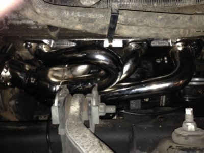

Finished!
All done clearances are good bolted on no problem
I had one bolt I had to drill out no problem with that
Little tricky getting to a few bolts but some flex head ratcheting end wrenches helped immensely

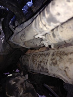

Drivers side
