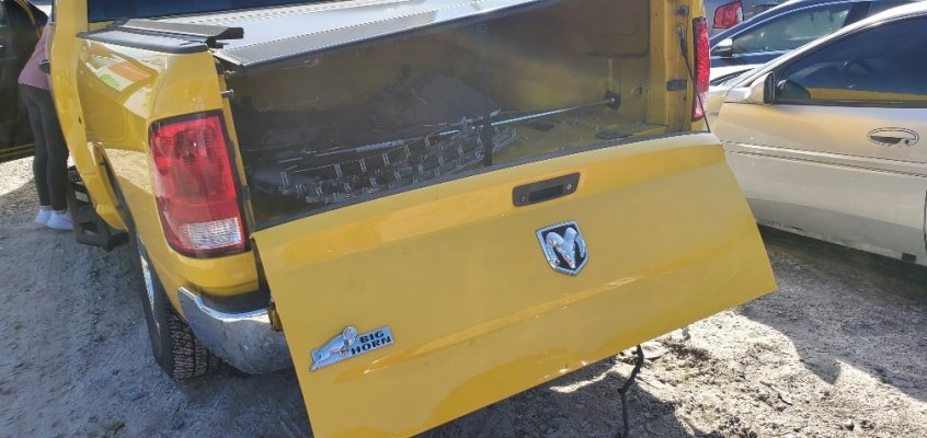

It was another truck I was told. I was unconscious then delirious when the ambulance took me away. He was doing 60+ I'm sure cause the speedlimit is 55. The cop said both vehicles were totalled.

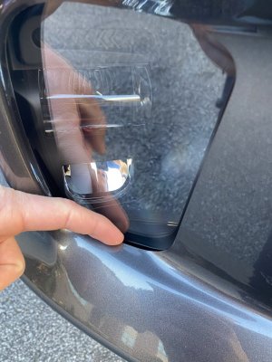

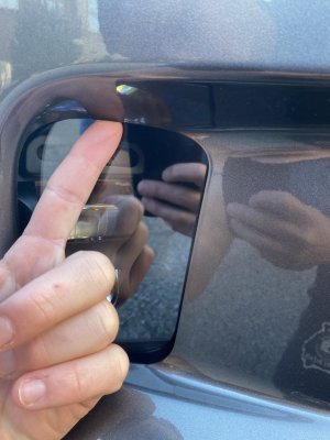

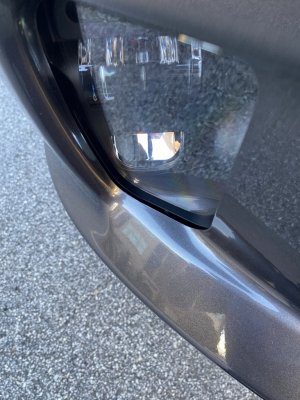

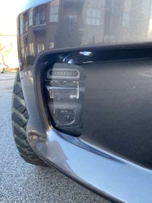

There is maybe 1/10 of an inch gap so it is barely noticeable from the stock lights. It made a huge difference as I too had a large gap. Even after turning the adjustment knob. It also helped them face out instead of in towards the middle of the bumper. I have a thread up called Headlight Options and I put up some photos on there. I can take more during the daytime to show the gap if you want. Another person ordered them and the stock bracket side holes are larger than the pins off the sides of the lights so his may not work. But I think it will with a rubber washer around the pins.

Here are a few of them. If you need some more just let me know or look at my thread on Headlight Options. Using the stock brackets helped a ton. The driver side has maybe 1/10 of an inch larger gap around the cutout, but you absolutely can’t tell unless you look hard. If you need any tips just reach out.

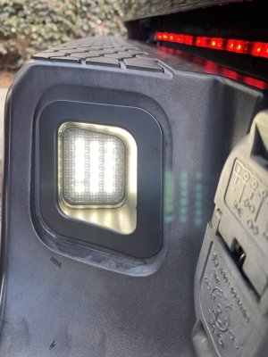

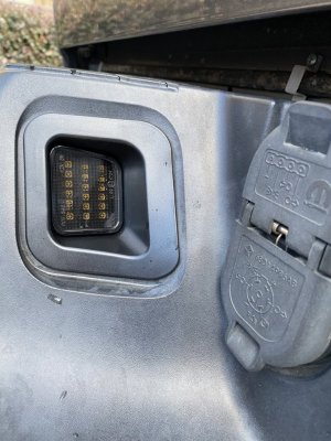

Where did you pick those up?
I found them on Amazon for under $30. Just type in your year truck, ram, and tag lights. They should pop up. Mine are the VIPMOTOZ. The pin on the rear of the lights is a bit of a pain to pull and put back in. But took maybe 15 min to install. They look a heck of a lot better than the stocks though.

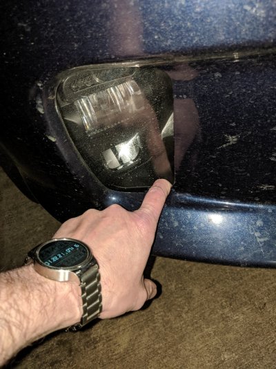

That is a ton better!
I can get my entire finger in mine.
Thanks for the update brother.
AND I know, I know. My truck is filthy lolc25b16487103e0a1a5bb322e718dfed2.jpg
