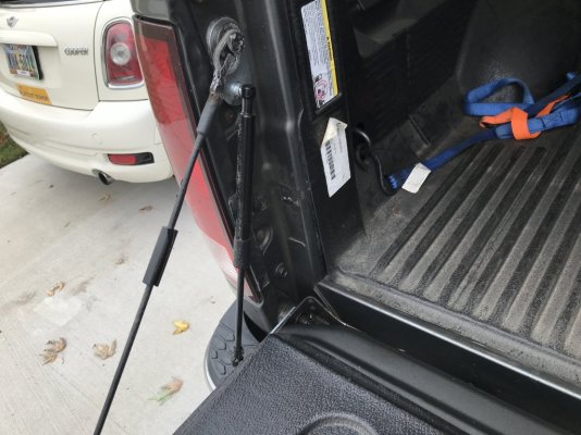

I’m about 58 pages into the mods, and I had to do a couple. I added the tailgate Dee Zee assist, and a cabin air filter. Also, I Fluid Film sprayed the entire underside of the truck. It originally came from Nova Scotia CN, so it was a little rusty underneath. Replaced the passenger side rocker and cab corner, too. Also bought a Uconnect 8.4 VP4 NA to replace the VP3 CN radio… curiously, it doesn’t have USB port’s available! The radio is a 2017 out of a Ram 1500 Sport. My old radio had them visible in the Media area, but didn’t have Nav, this one has Nav…
I used a plunge cut vibrating metal blade to cut the hole for the cabin air filter, which I bought from Amazon for $15 and change. Worked great. The Dee Zee tailgate assist was only $28 too. I like it.

DeeZee will NEVER get My Business Again!
After I’ve been their customer for 3 trucks and a dozen years…. I ordered their latest tailgate assist kit…(3rd one I’ve installed, altho’ this design is slightly different) …and when it had an installation problem…I called “Customer Service”….and the gal got “short” with me when I questioned her suggestions…. she said, “If you don’t want to follow My instructions then do it however YOU want!”
I replied, “Madam, I’m not trying to disagree… I’m trying to make this thing work and help DeeZee better prepare their instructions..” …and She HUNG UP on me.
I called back and talked to ‘Jason”…. who acted similarly and told me “DO it however You want!”
The problem was/is: Their cable bushing is defective and their installation instructs, if closely followed, will result in a “Jammed” cable behind the gas-shock which will be damaged.
I found an aftermarket (copy-cat of the DZ previous design) which works perfectly, just like the previous design did.
There’s simply NO REASON to be rude to a customer seeking help.

I did those on two of my previous Gen 3's and forgot all about them. But they worked great. Don't know why I haven't put them in my last two Gen 4's. I just forgot all about them I guess.

I got to figure out how to fix mine
I installed one when I bought the truck, but the hole in the tailgate wallowed out and I haven't been able to figure out how to reattach the shock yet

If you contact DeeZee they "might" have a fix for this. I think they sent me a repair kit free of charge but it's been a while...

Couple of reasons why thats not an option, first off knowing myself, im sure i went with the cheapest option available, so i doubt its a Deezee brand
Secondly, I tried fixing it a few way so that 5/16 hole is now somewhere around 1, 1-1/4
I really just need to peel the tailgate apart and put a bolt with a fender washer on it

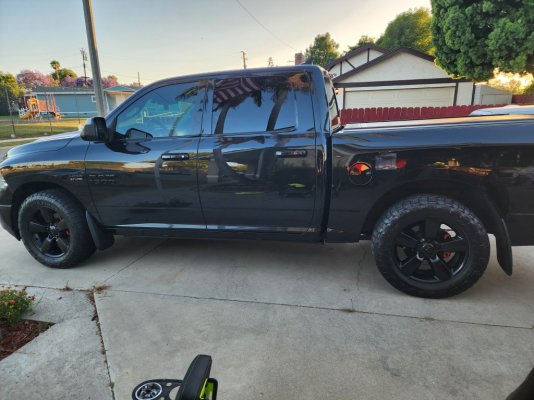

So this one wouldn't have qualified, except I found a smoking deal on Gorilla black lugs, actually got 24 for $89 on Ebay.
BEFORE
AFTER
yes, I can count. I only needed 20 of the 24, but it's never a bad thing to have some spares in the parts bins

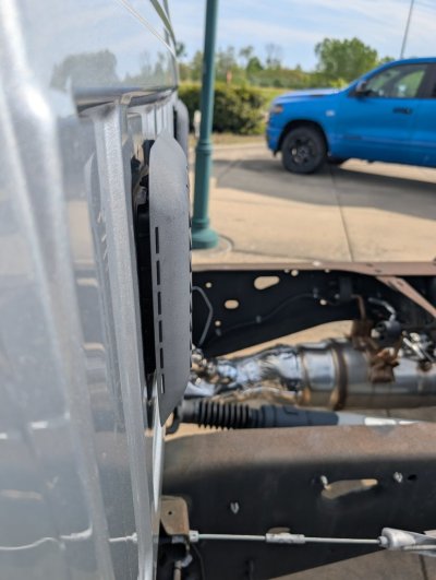

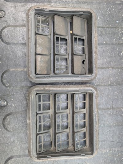

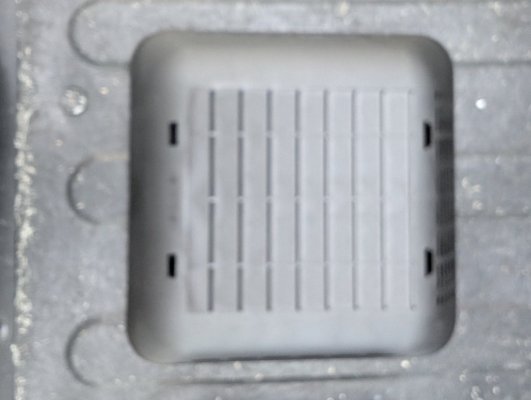

PSA. Just a reminder if you haven't replaced your cab vents and your truck is early to mid 4th gen, get the revised part. It has better vent flaps and a drip pan.
You can buy the heavy duty ones but they are meant for trucks without beds and the outer cover must come off to fit.
