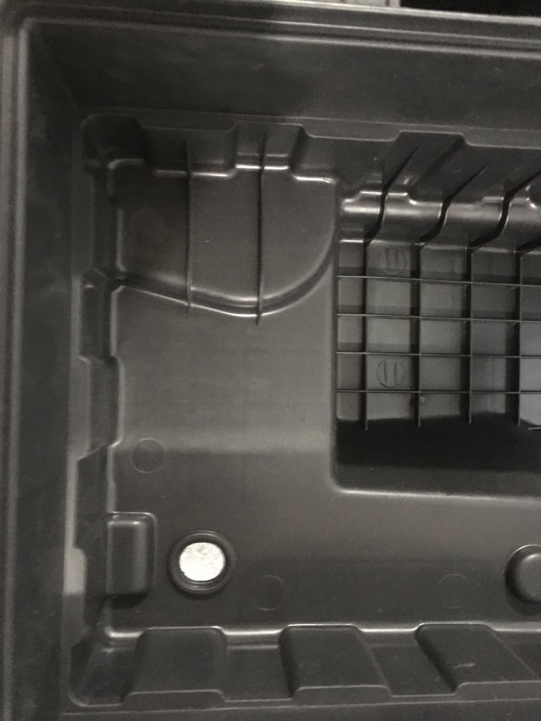

Above a closeup of the Hemi box.
Below a closeup of the EcoD box.
full
For some reason the EcoD box removed the small cut out in the Hemi box seen above. Everything else looks the same to me and my tape measure.
Maybe the cut out is necessary in the Hemi box due to the considerably smaller inlet tube.
I'm guessing the cut out area is clearance for something under the air box. The EcoDiesel filter pleats are deeper than the Hemi, so you would think more area is needed inside.
