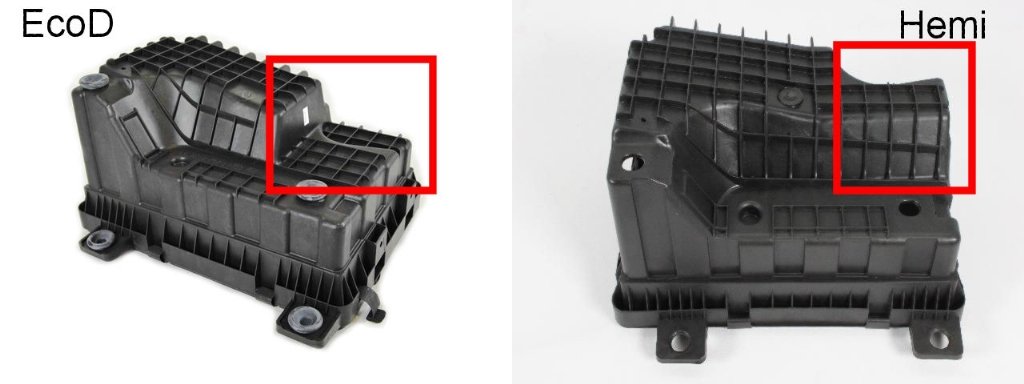

I was looking at the pictures on AllMoparParts for both airboxes and noticed something. It looks like the Hemi airbox has a larger internal volume as there is a section that is not there on the EcoD part (see pic below). Not sure what the difference would do, if anything, but I thought I'd point it out.
Can someone who has ordered the EcoD part confirm if it actually is different? (i.e. The picture isn't outdated or otherwise inaccurate?)
-K
My parts showed up the other day and I hope to get to it this weekend.
In the first pic Hemi395 posted that does not look to be the case. The EcoD box looks way bigger internally too.

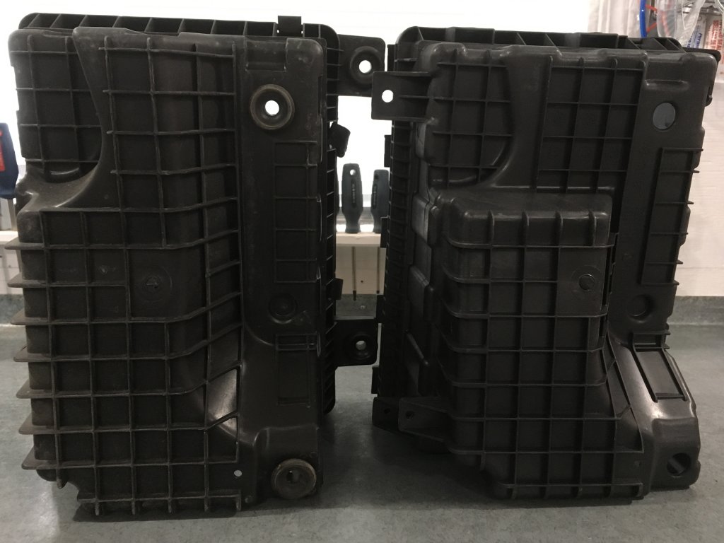

I will take some pics if nobody beats me to it.

Hemi (Left) EcoD (Right) Bottom shot above.
Below the inside of the lower air box.
