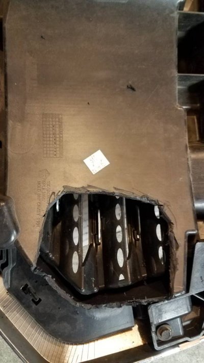

Trying another little free mod. The factory air intake gets it's air from the fender but there isn't a real good flow into that part of the fender except around the passenger headlight and from under the truck. I pulled the grill off and saw a spot I could cut a hole into that would feed it fresh air going down the road. The Cummins trucks take air from around the same spot. Pretty simple to make the cut with a Dremel. Yes I know my cuts suck but it won't be seen unless the grill comes off[emoji4] Keep in mind with the honeycomb grill this could be a LOT more obvious.
I'll post later if this actually helps with intake temps or not.1103d3c09602df0f9364eb60a00f2209.jpg64c62fc0e49018780686f1b5e2aef77b.jpg33d6c6874dad8be45842c7bf6c39ebee.jpg00474e7088fb4f16e972d5c5fcb75b4c.jpg
Where is this cut you made?
On the passenger side, lower half of the grille cover??
If so, my 16 has that cut out from the factory.

Yup. It's factory. I went out and looked. So, I'm guessing that the factory decided to start doing this in 2014? Cool. One less thing I have to do. Hahaha.
Yeah mines a 13 so it must have been 14 they started cutting that out. Cool thanks I'm going cut mine like your pic [emoji106]

So it's pretty much confirmed that 2015 and up have this opening and 2013s don't. Anyone with 2014 that can that their grill??

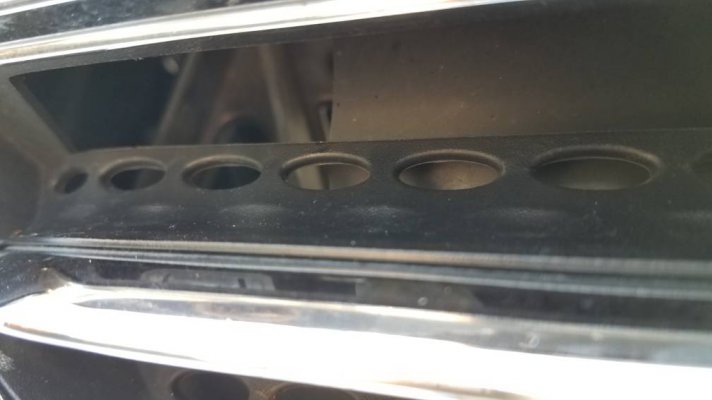

I just realized he put a grill on from another truck so 2014s might not have this cutout...
I just took a look at my 2014 (through the grill with a flashlight) and that area seems to be blocked by a cover of some sort. I'm not sure if it's part of the active grill shutters or something else. I'm planning on having the grill off in the next couple of weeks to do some headlight work so if this hasn't been definitively answered by then I'll post on what I find.
