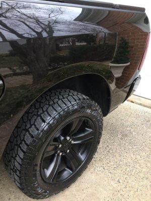

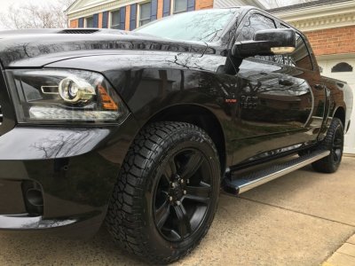

You shouldn't rub, especially if your sticking with a 275. Jumping from a 60 to 65 (33" to 34") will put you in an E rated tire (10ply vs 4ply). I did this with my last Ram 1500 and I didn't like how the road felt rougher. If you're just looking for a more aggressive looking tire, with better ratings, and better handling look at Falken Wilpeak AT3 275/60/R20. I put these on my truck without sacrificing ride quality or mpg's.. Plus they look good!! I'll be getting these again when the time comes.
Here’s a couple of pics before I raised the truck.
BAC628D1-A3C6-4123-A9A9-4AF8DEDC67A4.jpeg E7AD402E-8723-4CBE-9CB3-2D6C9785690B.jpeg

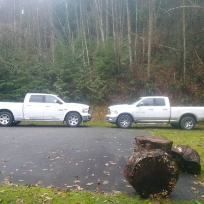

275 65 20 ridge grapplers on my 17 with air ride. No rubbing even in entry exit modeIMG_20171204_111737.jpg
